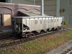

I use those 29 cent 1 inch wide paint brushes made with hair sold at Wal-mart in the crafts section.
I pour the ballast down between the rails and push it down the center. The overflow starts to naturally apply a shoulder to the ballast on either side. I then apply my ground cover using plain dirt, demagnatized and mixed to varying degrees with Woodland Scenics ground foam. I'll add grass and foliage clumps as I move away from the track. DON"T SNEEZE!!! :eek:
I then mist it---this is key, do not do this until you've found a bottle that mists properly---heavily 'til it's good and wet. If it balls up, it's because the water isn't misting enough most times. My bottles come from the cosmetics section in most dept. stores. My "wet" water is a mix of water and a cap full of rubbing alcohol.
I use the empty Elmer's Glue bottles as droppers, a little practice and you'll never go back to an eye dropper. I use a standard 50/50 mix with a dibble of alcohol in it, then just pour it on carefully, starting between the rails and working out.
Hope that helps, BC
