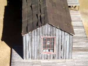

Since the subject is tar paper...
Here's a photo of a "tar paper" roof on a structure that I'm currently scratchbuilding for a freight house diorama. Because it's an old structure, I wanted the roofing to appear heavily weathered and deteriorated.
Jon mentioned "cheap construction paper," which I frequently use for tar paper. But this is even cheaper! It's made from a half sheet of newspaper that I sprayed with Floquil Roof Brown and then weathered with raw umber chalks. (I also have made tar paper from a newspaper sheet sprayed with Floquil Grimy Black.)
A half sheet will give you enough material to roof a bunch of buildings! And if you use one of the "freebie" local newspapers that gets tossed in your driveway once a week like I do, well, it can't get any cheaper than that! Your only expense is a small amount of spray paint. Just spray both sides and let it dry for a day or so, cut it up and attach it with an Elmer's Glue stick.

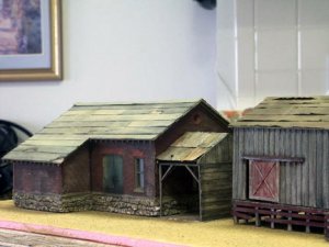

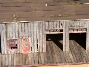

You are correct, Pat. Another contributing factor to the "warping" is applying the glue only to the top edge of the strip instead of the whole strip. You can see the difference in these two photos. In the first, I applied the glue stick only to the top edge.
