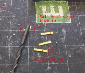

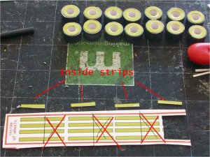

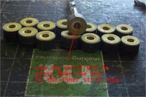

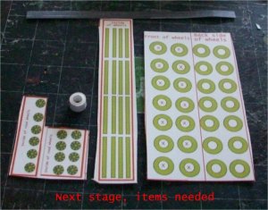

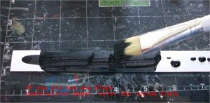

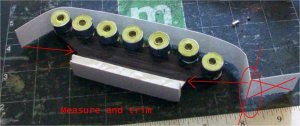

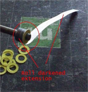

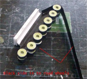

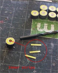

More on the road wheels
The inside strips are a bit large. I will adjust them on the plans.
Roll them with the color side in, then place it inside the road wheel. Place it to the edge of the road wheel. The inner edge will act as a stop for the wheel hubs later on.
Punch or cut out the X part. This will be the outer ring.
When you place the outer ring on the drill bit, it will serve as a guide for the black extension strip of the road wheel.

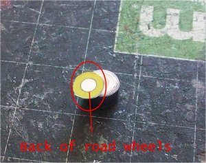

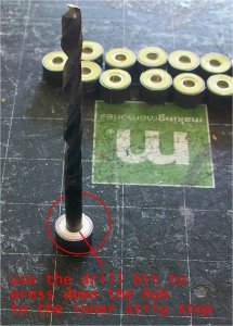

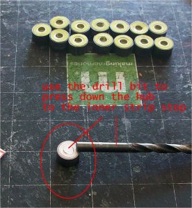

silveroxide

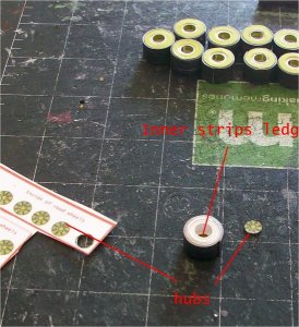

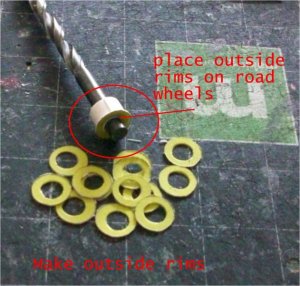

More road wheels
In continuation with the road wheels... With the inner strip in place, it will act as a stop for the hubs when you force it down (gently) with the drill bit.
Don't worry about the white edges, it will be taken care of later.

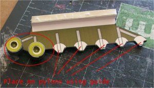

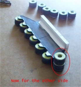

silveroxide

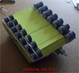

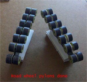

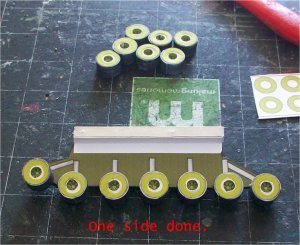

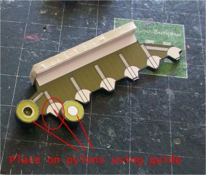

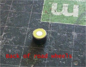

Road wheels
Attach the back of the roadwheels. Do not cut out the center portion. you will need it to glue to the pylon.
Place the roadwheels on the marked side of the pylon. Once they have set, turn the pylon over and guide the back roadwheels using the outside roadwheels as a reference point.:wave::wave::wave::wave::wave:

end of road wheels
This makes for the end of the road wheels section. Originally I was going to make the track guides but Then I decided not to. As you can see, the road wheels spacing adapts to a center track guide if you should decide to make one.

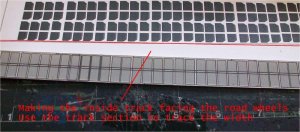

silveroxide

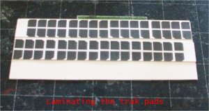

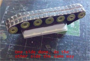

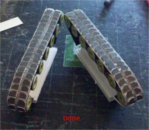

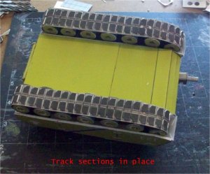

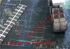

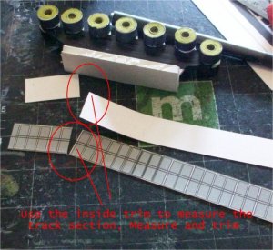

getting there
This build is almost over, it just need small details to make it stand out.
1. I glued the track pad strip on posterboard and trimmed out each pad individually.
The third pic is a track section finished.
2. Using the track section, I used it as a template to make the inside of the track.
3. I then wrapped it around the road wheels and cut it at the top front instep and top rear heel See arrows.

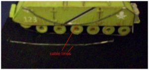

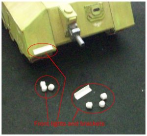

I will be adding some accessories to this build. Items to come will be the tool sets, ammo boxes, fuel cans, ropes and cables, folded tarps and a few other small items. enjoy:wave::wave::wave::wave:

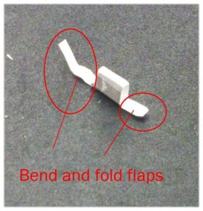

almost there

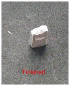

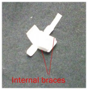

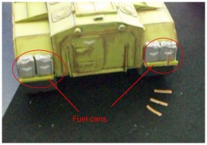

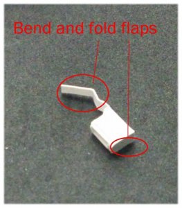

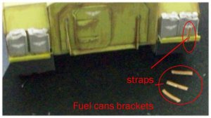

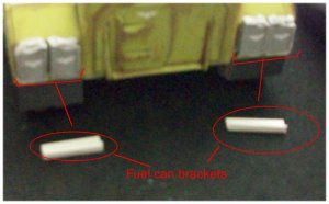

Getting to the end, just small details left. Here is a section on building the Fuel cans.
I use internal bracing using laminated 2X posterboard, but you can make it with paper tabs as well. The parts are too small to add the tabs. If you draw the tabs and fold on them, they will wrinkle at the edges /corners.

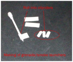

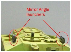

Smoke/gfrenade Launchers
Smoke and Grenade launchers. I used a paper stick to roll the strip into a hollow tube.
Made two brackets and glued the tubes facing forward on the brackets.
I placed them on the slanted side hull but they can be placed in any appropriate position you deem fit.:wave::wave::wave:

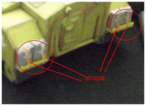

almost finished
enjoy, this build is done, any more pics will be extra add-ons. The plans are available in the download section. You can find it in the movies and games section or in the left column for now as a latest download. :wave::wave::wave::wave:

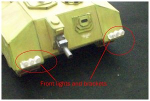

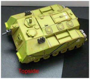

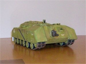

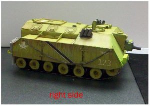

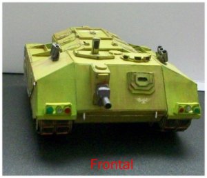

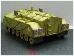

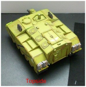

Finished pics
Here is where the Chimera is at at his time. There will be some add-ons in the future but for now, here stands the CHIMERA.:wave::wave::wave::wave:

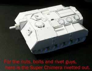

This is a basic hull model. My future projects were to incorporate a frontal cannon for a tank killer version and the turret was also in the works. It is just that I overwhelm myself sometimes and I have not gotten around to the add-ons, ie the turret.:cry::cry::cry:

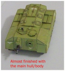

Here is a pic of the Chimera with the bolts/nuts on it which I did not get around to do, this is from the beta build.
