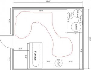

Hi all,
Here is a drawing of the room I have to work with. I'm looking for ideas on where to place my benchwork. This will be for an HO layout and I'm leaning towards a mining or logging industry.
I don't have a track plan in mind yet. I want to see what kind of benchwork I can fit in this space before I decide on one. Please let me know what you would do with the space available.
Thanks!

Extreme PC,
The only advice I would give you would be to make the layout modular so that you can move it in case that well tank or furnace needs replacing you can move the layout easily. Modular does not mean only 2'x4' sections. Mine are a variety of sizes.

just make sure that you can access all sides of the table at all times. its a lot easier to work that way... for me n e way....

I would suggest you confine the layout to "around the wall". That way you can always reach anything on the layout. Don't attach it to a wall, but have it free standing and build up your background with plywood sheets.

They don't design furnace rooms with model railroads in mind!
I agree with the shelf layout idea. Do you have to stay clear of the water softener area? I think you should leave the the little square beside the furnace clear.
Are those clearances you've drawn or just box sizes for the furnace and water heater? See how much room you need to leave.
I would like to see a single track through the watersoftener area if you get the clearance.
I would like to see a single track through the watersoftener area if you get the clearance. It could be the break between the logging/minimg area and the outside connection.

Nope... They sure don't! :) The only issue around the water softner area is with adding salt. I need to get the the salt bin every 2-3 months. The options I am considering are making a lift out section to cover the area, or the more drastic one of moving the water softner and well pump next to the water heater. Shouldn't be too big of a job... I'm pretty good at plumbing and electrical work. That would allow me to do a fairly large L shape... something like 4x10 x 4x8 and still have room to walk around.
Just need to clear it with the boss (aka wife) :)
Thanks for the idears.
I think abutt is right, around-the-wall is best. If you try for a 4' wide table against the wall, you can't reach across it. Seems about 30" is the recommended max. Keep it plenty high and go over the tops of those tanks. The furnace I'd stay away from, but you can maybe work around the water heater. As you know, someday it will need replaced :D

You could actally do it right against the "HW" wall and have a break in the middle to walk through or even under as no doubt the table near "HW" would be so close it would make little difference.

Is this your entire basement? Is the doorway coming from a garage? Area seems small. I don't think a water tank is a heavy maintenence item, but a jet pump is. That's sucking water up from a well rather than a submersible that's pushing water up. They're noisy and tend to fail.
If this is your only area, I would consider an "L" shape moduler urban switching layout, one leg along the 10' wall, the other in front of the door along the approx 11' length with a duck-under. I'd construct it with modules of 2 to 3 foot lengths, 18" deep.
Don't forget, you trap something like a hot water heater, and you know what's going to fail! Burner service people would have no trouble ducking under the entrance...besides they love model rairoads.
Any other kind of "free-form" layouts are going to require very tight radius curves in HO. With the 18" depth you wouldn't even have to power your turn-outs, just use hand-throws. That's what I do with an MR walk-around control.
Good luck, and keep us posted.

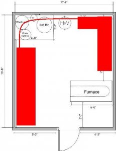

If you can move the hotwater heater to a group with the pump and water softner, you will clear two good lengths of wall. If you can connect them with a removable "bridge" section, then you can do a point-to-point in this area.
I would also second (third?) the idea of a modular layout - maybe not in the "portable" sense, but at least the "movable" way. That is to say that if necessary, the layout can be taken apart and moved to prevent damage or provide access.
You can build your own modules much more cheaply than the WS Mod-u-rail modules, but that does require some planning and carpentry. See some useful links in the Modular forum (click the link in my signature).
I have attached a diagram of what I mean. You could do something similar if you moved the water softner, but I don't know if you can move the pump - if not, you will still have two obstacles in addition to the furnace.
Andrew

Andrew's idea is a good one. I'd stay clear of the water tank because it might be too high. But you certainly could have enough elevation to go over the softener and salt barrel, and of course move and run behind the water heater.
