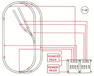

For power if u don't go DCC than u will need a trottle for each engine. Here is a diagram showing a dual cab system. If u go this route i would purchase a book called "Wiring Your Layout" by Atlas or check it out.
