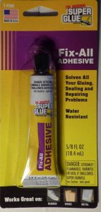

Well, I've found a silicone glue called FixAll (made by the SuperGlue people) at the $ stores around here. Nice size tube. Does paper well and I also use it to glue paper wallpaper and other paper interior things to the plastic walls of some kit built buildings. If I plan on many interior lights I first glue a layer of "black" construction paper to the inside walls and cut out doors and window areas (works best if you apply this layer before gluing in windows and doors) and then glue the second decoration layer over that. So far, after several years of use, nothing has come unglued.
Have fun, Swamp Daddy

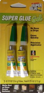

If you like SuperGlue you can also buy it at the $-stores, comes in regular liquid (and also in 5 small tubes), each a $. I prefer the slower drying and less apt cause trouble gel version which is also less apt to stick your fingers together. Keep a bottle of nail polish remover handy in case you do glue yourself together. I only use this on metal to metal. Two nice GEL tubes $1 or a 6-pack of miniature gel tubes for $1. I find the small tubes not too useful as most projects require more than one. This type of super glue has the usual setbacks of the liquid version: fumes (ventilation needed), fumes will mar almost any surface that they touch. A thick piece of cardboard between it and your work surface is a good idea. It's handy, the tubes do not dry out fast so I never bother with the refrigerator for them.
have fun and be careful with this, Swamp Daddy
PS-got the pix uploaded, package about 6.5" tall
