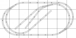

Thanks for the sites and opinions/comments. I've came up with a layout idea that I think should suit my purpose of a beginner HO layout. I have all the track peices from that train club except for the #4 right hand turn.
If you notice the name, I was tired when I was finished and couldn't think of anything.

Its a nice design, but that upper spur is gonna have one heck of a turn radius. Looks like about 15" from here. Are you running mostly short equipment?

If you run clockwise around the layout, the bottom set of spurs will be trailing point, but the top one will be a facing point. You have no run around track on the layout, so you don't have a way to get the locomotive behind the cars you want to push into that spur. If you run counter clockwise, the bottom set of spurs become facing point with the same problem. If you make a passing siding on the top of the layout, and bring the top spur off of the passing siding, that solves the problem. It will require 2 more #4 turnouts.

Looks good to me,in fact I'm going to do somethimg similar just larger with a 6x12 or so w/30" radius' layout.
