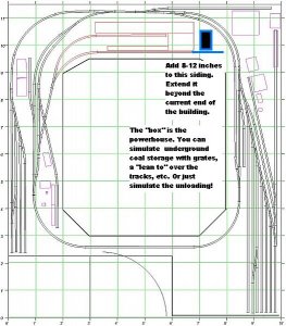

I might have missed some info (happens all the time) about the "time frame" of your layout. The reason I ask is there is potential for another siding to service your industry. (which has/hasn't been decided??)
If you are modeling anytime up until the EPA era, coal was used for heat and power generation. A siding for the occasion (weekly or bi-weekly) hopper of coal could add some interest. I can draw it out for you, if you like the concept.

Hey Tim, thanks for the reply. I don't have a time frame yet, and may never have one.
Thanks to Mason Jar's idea, I can squeeze three sidings in there, so that would be a reason for the extra siding. I have no idea what I would need for that, so if you could draw it out, that would be great. Thank you.
Loren

Loren,
I've attached the drawing below.
Originally, my thought was to bring a short spur off the mainline on the right side of the drawing towards the powerhouse location.
Then it came to me; if the "needed" coal action was less than the other activity on a spur, that spur could be "extended" to handle a carload or two. The switching of the hoppers could be done whenever that siding needed to be pulled. You could change this concept to fuel oil by adding a small oil storage tank in addition to the powerhouse.
Just some ideas. Your layout, your choices, you're right!:thumb:
Regards from Ohio
Tim

Nice idea! Makes the industry seem that much bigger - having its own powerhouse and coal track. :thumb:
