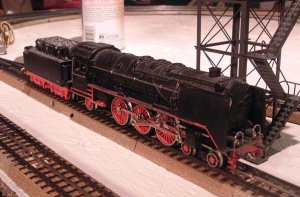

They had two types of the old three rail. The newer had textured ballast and nicely spaced stamped tie detail. The older type had flatter detail on the roadbed and the ties were spaced a bit further apart. Which one were you looking for? This is my O1 on the newer 3 rail...

Should fit on a 32" door just fine, this O1 has a "blind" or flangeless center driver that takes the regular Marklin track curves well. Don't know the metric equivalent but it's about a 14" radius.
