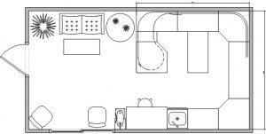

Hey guys! Good news! My wife has agreed to let me use part of our sunroom for a layout! I spent the new years weekend cleaning it up and getting it ready. So.. Here is my question. I'm switching from HO to N (Me and my wife done a little 2x4 layout for the coffee table, she like N better than HO, she say's they're cute, I tell her they're trains, they're not suppose to be cute, but she doesn't believe me!) anyway.. I drew up plans for the bench work in Visio. Attached is a jpg snapshot of it. I decided to go with the modular approach because we're a young couple, and moving is inevitable.. So, I wanted to get some people's opinion as to the trackwork.. I want to incorporate the following features if possible.
Town/City
Trestle Bridge (over a gorge or water)
Mountain with tunnel
Yard with Turntable
Passenger station with enough track line to allow the Kato Super Chief (A-B-B-A) with all 12 cars to be stationed waiting for passengers
Run-around capability
industries
and a liftout/bridge
I know this is allot to ask in a layout, but it's a pretty big area I think. The modules are to be 3 - 2'x4', 3 - 3'x3' corners, 1 - 2'x'3 and 2 - 2'x2' -- Oh, don't confuse my workbench sitting between the sink and drill press as a module! :)
Let me know what you all think!

I was kinda hoping someone could help me come up with some sort of track plan that would fit all my requests and work on this bench work..

I think it would help if it was moved here. You should also give us some diensions for the room, and the benchwork. Finally we need to know what era and size equipment you want to run. The size of the benchwork will determine the minimum radius you will have to run to make a loop and the era and equipment listing will tell what minimum radius you will need to run.

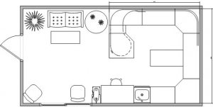

UPDATE: The door in front of the lift out has been taken out of the picture.. My wife is now going to let me put a full sized module there.. which means I don't have to have a easy path to the door now, which means I can do some other things. Attached is two more variations with the liftout replaced with a full sized module. Bench work is still up in the air.. as well is the track work.. So far, I have 2 2x4 modules built, and enough lumber for 2 more. BTW, Looking at stuff.. I think all my rolling stock will work just fine on 11 1/4" Radius track. Not exactly pretty on longer stuff.. But.. It works.. I would prefer larger radius, but, not locking myself into anything.. Anything 11 1/4" or larger is fine.
The area of the layout is in is 11' x 11 1/2' The new module in place of the lift out is 2' x 5 1/2'
Thanks Connor

Remeber now, This is a N-Scale layout, not HO. You can have a use a 11 1/4" radius and look good with most rolling stock.

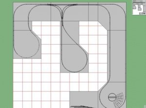

Okay guys, here is my attempt. This is the start of the track work.. Let me know what you think.
Thanks, Connor
