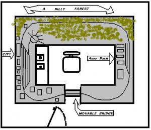

Remember, that SD60 that you bought was sold because of my layout's 18" radius! You migh need 24" radius or wider, or else It'll look funny, and You can't really use snap switches either, because of the sharp 18" radius. I'm not saying that it can't run on 18" radius, But the overhang will pull cars off the track!
Perhaps you could build a layout shaped like a doughnut, with you in the middle, accessed by a swing bridge. It could be wall to wall or in the middle of the room...LIKE THIS:
Ok here we go: 30" Radius, plenty of room of curves. An army base on the right side, with a yard, and city on the left, with a hilly forest land in between. It's easy on your back, because all you have to do is lift up the bridge, and walk into the middle. It's be no more than 3feet on any side, maybe except for the hilly forest. Then you can sit in the middle, and watch your trains run!
