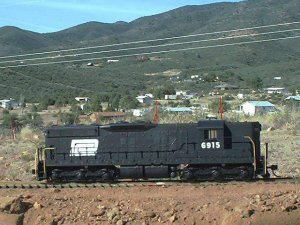

I took a few photos of some of the locos I just painted.
The photos are a little fuzzy.

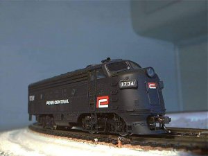

PC#1734 is an old Bachmann F9 shell modified to represent a phase II F7. It is powered by a heavily modified Model Power dual drive F7 chassis.

You should enter these in the scratch competion. That GEEP pix is WOW. FRED

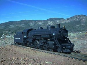

P&LE #9236 Was built from the junk box. A remotored, regeared IHC loco and a shortened Tyco tender shell on a modified Tyco caboose frame.

Oh yeah!!!! Those are nice Ray! That F unit looks particularly sharp with the red P. Say, where's the PC logos on the steamer!? :p
Beautiful work as always!

The P&LE #9236 is almost the exact model i have in my basement that persists not to run. It also refuses to yeild any information on its maker or any instruction sheets.
The motor is also shot in it.
Do you have any of the instruction sheets or any info on the motor you put into it???
I have been searching and working on this engine for 2 years now and have failed to make it run.
Does yours have a steam bellows in the tender?
Eric

Eric,
The only loco I can think of off hand with the smoke unit in the tender is an American Flyer Hudson. There may have been others.
Is there a number 6318 on the cab and New York Central on the tender?
The motor I put in #9236 was a 6 volt, 7 pole, ball bearing motor I salvaged from an MSA portable air sampler.

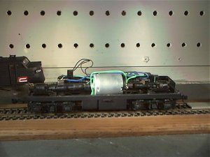

This is a photo of #1734s chassis.
Electrical pickup was added to all wheels.
The worm and worm gear were changed to give it a 20/1 ratio as compared to 9/1 and my favorite motor from a VCR was installed.
Some milling was required for the motor to fit and a mounting plate was fabricated on one side and a support bracket on the other.
The motor was made into a double shaft motor by pressing the shaft further through the armature using my drill press as a arbor press.
This is a VERY delicate procedure as you must support the commutator as well as the polls when pressing to prevent crushing the commutator.
Styrene was added to the sides and rear to widen the chassis to the dimensions of the Bachmann shell. Mounting tabs where also fabricated.
The truck mounted coupler mounts were cut off and KDs were mounted on the chassis.

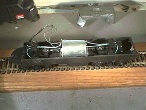

This is an Athearn chassis with the same type motor. They are a high torque motor with a lower RPM.
This will power the F7 A-B-A set I'm finishing up.
