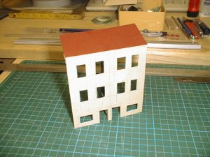

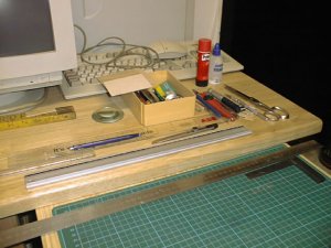

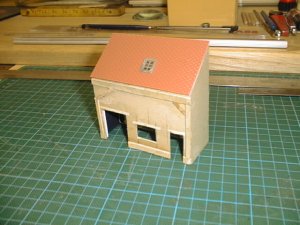

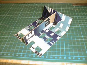

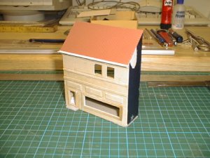

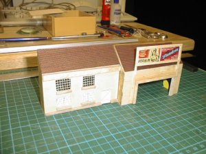

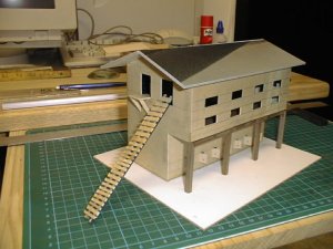

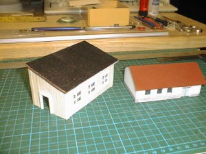

This is a lot of pictures from my second try , nothing very spécial , but it start with scartching last week for the first time !!!! ( hum !!! )
I found on this forum, 572 pictures from MY MASTER Robin MATTHYRO , and save this collection images on cdrom for the ETERNITY !!!!! ;)
also i am veery sorry , but I dont speak verry goed englisch, I spaek only French and Flemisch !! :cry:
Bye for every one
roger Flytox Belgium

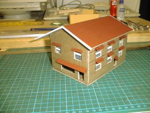

second lot of pictures
second lot of pictures ..... :eek:ops:

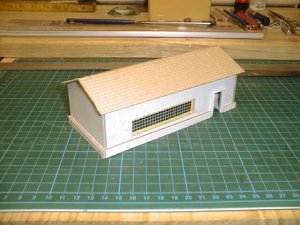

3 lot pictures
Lot pictures Nb 3

Nice work and a great tribute to the tradition of carboard scratchbuilding that Robin excelled at and shared with us. Your English is fine by the way. Welcome!

The scale ??? thats the Big problem for me now !! I dont now ( new be !! ) I wand construct all my "models " in scale HO / 1:87 !! but i dont no how !!! I must absolutly learn on this forum site !!!! All information is welkom for the "Big New Be " that i am !!!!!

If you have measurements for a prototype building, ho scale is 3.5mm=1 foot. I'm not sure how it measures out in metric since you wouldn't use feet in the metric system.
NYCNewbie
Forget about feet and inches. With metric, it couldn't be easier. Assuming you have a calculator, it's simple. Just divide any real-world measures (in meters for example) by 87, and you get the model length in HO, also in meters. Multiply the result by 100 to get cm, by 1000 to get mm.
1m (prototype) = 0.0115m (HO) = 1.15cm = 11.5mm
10cm (prototype) = 1.5mm (HO)
10mm (HO) = 1cm (HO) = 87cm (prototype) = 0.87m
1mm (HO) = 87mm (prototype) = 8.7cm = 0.087m

Hi, I am assuming you are working with metric numbers, which are more intelligent than the "English" system we use here in the USA. The reason for the stupid 1/87 ratio is that it is a combination of English/metric and American/English measurements.
If you want to estimate the sizes of your buildings, and want to easily scratch build, you can use the following approximation.
Estimate a length of something, divide by 100, add 10%.
For instance, say a building is 30 meters long and you want to determine how it would fit on your layout. Divide the 30 meters by 100 which would give you .3 meters or 30 centimeters? Add 10% (.03 meters) which gives you .33 meters or 33 centimeters.

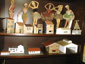

Mr. Fly, your modeling and English are both quite excellent! And what better way to display your buildings than beside ceramic chix in mini-skirts?
Why didn't we think of it!
Why are you having trouble with the scale? Is it the math? Is it conversion of prototype (1:1) to HO (1:87)? Or metric to standard to HO (what a mess that is!)? or ??? I hope I do not offend you by asking! If you don't already have one, a "scale ruler" is a must! It is like a regular ruler, but it shows HO feet instead of inches or centimeters. If you are going from photograsphs, this howto may help: http://www.2guyzandsumtrains.com/Content/pa=showpage/pid=35.html
(originally a gauge howto, then the pics died when my website died, then my friend took the time to fix it up for me).
Inneresting the different roofing materials, could you expound on how you do the roofing? :D

siderod
I don't have any ceramic chicks, but i can probably get my girlfriend in a Mini-skirt to model some of my models...does that count? :D
Very nice work with the cardboard too, Flytox! While i still prefer styrene (easier for me, i guess), i've always been amazed with what some people can do with paper products!
