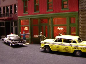

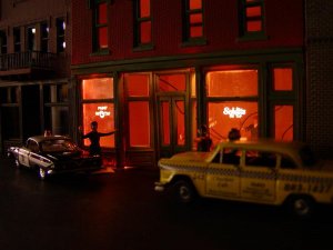

The information Bill D provided has turned out to be most helpful! While I didn't quite get moist I did get a glimmer in my eye when I first saw the signs light up. These signs are from Brommer, link in post above. The photos were hastily prepared, throwing a few items together, but should give an idea of the effect possible. The building will get a detailed interior and the wires won't be visable, not the base to make figures stand. And a road that isn't paper. What do you want for 5 minutes?

Looking good there Gary! Makes me thirsty just staring at it. Schlitz isn't that bad of a beer either. Tastes good and cheap - what more can you ask for? :)
BTW - are those wires inside the bar? Are they for the signs or something else?
Gary Pfeil
Tyson, Better your railroad than your home! BDC, yes they are the wires for thelamps, I was in a hurry to see what the signs would look like, then it was a matter of looking thru boxes for figures and vehicles. Just to post something quick. My plan is to build a bar with stools, a pool table and some tables and chairs. Maybe a rush hour crowd.

Gary Pfeil
Bill, I'm not sure what you mean. The signs themselves are laser etched on some type of clear acrylic or plexiglass and edge lit. The photo was taken with a digital camera. Thanks for the link! I'm thinking of getting one more sign to use on the wall behind the bar. I figure a large mirror the length of the bar, a sign in the center with the cash register beneath it, and shelves full of bottles on either side. Anyone know a good source for a lot of bottles? I thought to use styrene rod, sand a neck and cut to length, paint and call it good enough.
