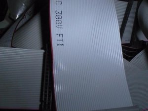

I happened to notice the other day that the surface of ribbon cable, used in computers a lot, looks a lot like a corrugated roof (in some scale or another) - just needs to be painted the right color.

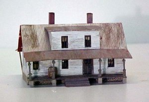

I've used Evergreen scribed siding to represent a metal roof...
Here's a Model Power house that I kitbashed with this type of roof...

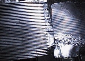

Thanks again for the suggestions. Here's what I did in the end:
I combined the "stamping" process described by trainclown with the suggestion for the ribbon cable from billk.
I sandwiched a piece of aluminum foil between two layers of the cable, making sure that the layers of cable were straight and "nested" together. Applied some pressure, and voila - corregated metal.
It is a bit oversize for N-scale, but from a distance looks fine. It is a little fragile, but will work well with some care.

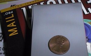

I forgot the penny, but this is about a 2" X 4" section. Used foil, so I think you could do a lot better with new. Might be better off painting the ribbon or using contact adhesive and pressing the foil into the ribbon cable. These are pretty fragile. The "fine" one looks about like the roofing material that comes in woodland scenics kits for HO.
