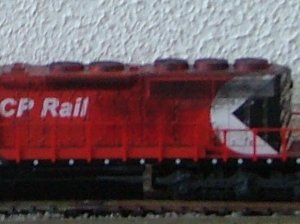

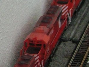

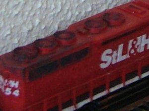

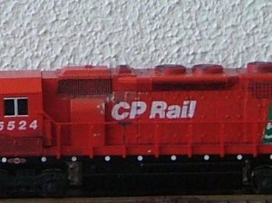

Its seemed to me that weathering pretty specific to era, engine type, and road name. I model almost all CP Rail northeast, which uses a lot of old Sd40-2 and SD60 power. I also model NS (they haul each others trains in the region) and they seem to take very good care of their equipment, as well as the black color doesn't weather as much as fade. I get a lot of railpace magazines to see what the engines look like now.
As for CP, I end up using a lot of grimy and weathered black. The roofs of the CP SD40-2's get filthy black, especilally the farther back to the rear you get. Also, the older SD40-2's tend to chip paint on the A.C. covers to a steel color. All of them get dirty around the front trucks as well. Newer paint schemes and engines get dirty mostly around the front trucks and engine fans and grilles, I see that in the photos a lot on the AC4400's. I use an almost dry brush and the thumb! As you get paint residue from handling objects on your thumb and grab the shell in the right spots it leaves a great weathering behind!

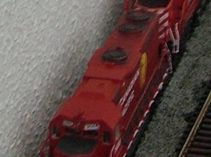

First Attempt
Well, I got out my oldest diesel (I'm not even sure what type it is...made my Trix about 25+ years ago, I think it's a U-boat, but not sure which one - still searching) and tried using isopropyl alcohol to rub down and remove the shine, then used 50% burnt umber acrylic paint/50% alcohol mixture on an 00 brush and a fine tip cotton swab. I looked at some pictures of weathered/dirty yard duty diesels for ideas on where to put the discoloration. The trucks were weathered with the same mixture but with burnt sienna added. If I can get it right on this one...I'll work up the nerve to weather the current diesels. The photo's seem to highlight the lines and areas that didn't get evenly weathered more than your eye can see. But since I'm working in Nscale, weathering so small of areas seemed easier to remove paint instead of building up a weathered area. All totaled, took me only moments and I'm all about keeping it simple and repeatable...but honestly, does it look like it took only moments and should I try another more elaborate technique? All honestly blunt critiques are welcomed.

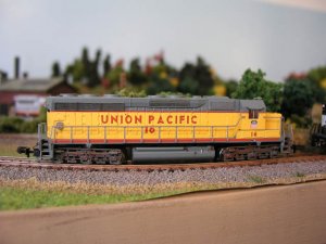

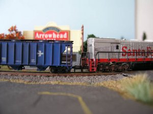

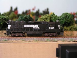

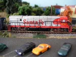

Well, finished 5 diesels with a light weathering. Good points MilesWestern... Here's two diesels that I did today as well. Right now all I'm trying to do is weather the trucks and body areas by the vents and grill work. Finally, my LHS got one package in of Ployscale RR colors so I have a few more colors to choose from. Still a work in progress.

Herc: you may find some interesting colours in the crafts store or even Wally world. They should run about a dollar a little plastic bottle for acrylics, less on sale. Look at the basic landscape colours and the range of shades of gray.
jsoflo
Feb 16, 2006
80
52
Ft. Lauderdale
That looks good, great start, love the look on the trucks. Also wanted to chime in that from what I can see of the layout their pictured on that looks great! Nice picture taking too, what kind of camera are you using?

Thanks...using an Olympus 550 digital that honestly, I wouldn't recommend. Doesn't take the best pictures, and was pretty expensive to boot. Set in auto, the pictures are only mediocre. I've been playing with it to get close ups of the layout...still haven't had the success I'm looking for. I think it's all in the lighting. From what I've read, two 100 watt bulbs in lamps (no shade) seems to give better light than what I'm using now. Plus, the room has a slanted ceiling - which really plays with the light bounce and reflection. I will stop by the dreaded Wally world for those paints...maybe see if they have any frabric resembling grass too. After doing a search on railpictures.net, it was easy to grab some shots of prototypical dirt on the engines. What amazed me, is just how dirty/grimey they are below the catwalk. Almost everything below those walkways was one shade of grimey brown.

Great job on weathering those trucks!
:thumb::thumb::thumb::thumb:
I'll give you credit, you were more brave than I've been. I have yet to experiment on an actual engine yet, as I've only done rolling stock. What you've done so far looks great, so I think it's time to bite the bullet and give one the full treatment.

Excellent! :Thumb: also might I suggest the LIGHTEST dry-brushing of silver to bring out the finer details in the truck? That would provide some pleasant contrast to the boxcar red(?) rusty color you have on your trucks right now. Good work, now try some freight cars! OH! and I forgot...are your UP trucks gray? If they aren't once again I'd suggest the correct color UP harbor mist gray. Hope this helps and thank you for being so nice about my earlier suggestions! :)

Silver is a good idea...and yep those UP trucks are gray (although grimier now). All comments are appreciated and always taken in the best light. I agree with the need for flat or dull coat after painting to work out the transition areas. So far...even the simplest weathering goes a long way to adding to the overall layout scene. I am really impressed with some of the weathering I've seen by contributors to this website. Some of you guys should hold a clinic! Maybe a thread of your best weathered car/diesel/steam/building and how you did it. Any takers???
