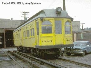

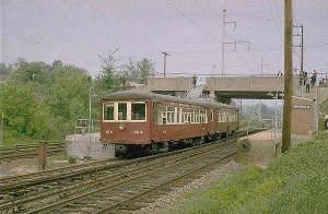

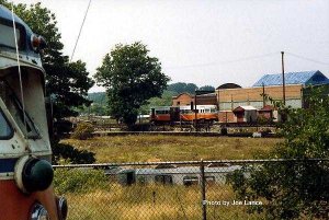

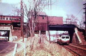

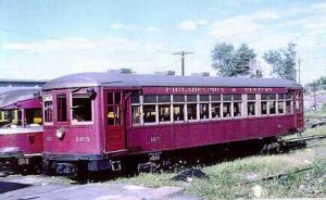

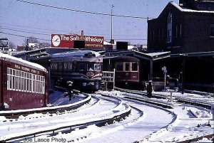

Hi TomPM,, I don`t now of any other makers of the Brill or PCC.
Most people have had good success with the kits.
Tricky getting them to run smooth with the pole you will need a stonger spring for contact to the wire!Her a few pic`s of Philidelphia West T/C. I dont know if they are what you remember.

Those are some great pictures. They bring back quite a few memories of the Pig & Whistle (the Philadelphia & Western). I rode the P&W to work for many years. I rode on the Strafford cars, the ones in the second picture at Wynwood Road. I also rode the Bullets which are in your picture at 69th Street Terminal. By the time I started riding the P&W the Liberty Lines pictured in the snow at 69th Street were gone. I heard stories from some of the old-timers telling about the bar on them and you could buy a drink on your way home from work.
The most interesting picture is the one of the Strafford car crossing over the Route 103 Ardmore trolley line at Ardmore Junction. The trolley going under the P&W is a Brill Liner and what I remember riding on the Route 102 Sharon Hill trolley as a kid.
