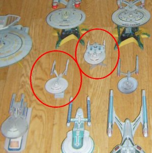

the scale is approximately 1/1000, and the ENT-A on this site is also 1/1000! both are in my fleet:mrgreen:
