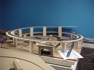

I guess i'm gonna like it in the future what a pain to get this thing up and running 17 feet long so far see photos

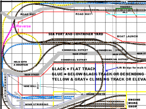

In other news can someone look at this and tell me if they see any reversing loops. I think I see one. Can someone tell me before I lay all this track and then have to redo it???
Thanks for the help!!

I think you still have to isolate that part and that means removing the rail joiners and replacing them with the plastic insulators. To do that I have to remove part of the track. I hate doing things twice.

COMBAT said:
Sooo.... anyone else want to confirm or deny for me there is a reversing loop on this layout??? THANKS!! :)
You only have one small section that will create a reverse loop. Its the pink colored section.
You layout's looking great!
You may want to cut a popup under the helix incase you have a derailment inside. It would be pretty hard trying to fix that going through the tunnel portals.

You have one reverse loop from the yard road tracK to the ship yard tracks LIFT BRIDGE WALK THROUGH AREA only. You can fix it by changing the direction of track to the right and save $35.00 on reversing electrnics.

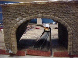

There Will Be A Mountain Above The Helix With A Hole In The Bottom Of Table In Center Of Helix.
The Mid Way Point Will Have A Open Track On The Side Of The Mountain Above The Double Track Opening Also.

HEY ALIENKING DO YOU THINK THE PINK AREA TO THE WALK THROUGH BRIDGE IS A REVERSE LOP ALSO

I agree with Alien King.... That is the ONLY area I can find that is a reversing loop. Other then that everything else is ok?????
There will be an open area under the helix. We will be able to enter the mountain from under it to clean the track..... fix a car derailment ect. :)
