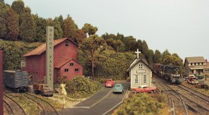

First thing I would do is (based on you said you wanted realism) is REMOVE the nails. If your track is not already painted flat black do so now before you ballast. I use Peco N-Scale code 55, if you used heavier code track it may still look a little out of scale no matter what you do. After the track is painted lay the ballast (I use Woodland Scenics fine grade med. gray color) to the TOP of the ties. Spray with a 50/50 mix of alcohol and water then follow up with a 50/50 mix of white glue and water. After it dries use a eye dropper and apply a 25/ 75 mix of india ink and alcohol to the ballast to "age" it. The tracks on right are Southern's mainline and done that way. The track on the left with the blue boxcar is a spur track and is ballasted with a 50/50 mix of "dirt" and "weeds", the track to the left of it is Nantahala Midland (shortline) mainline and is ballasted with a 50/50 mix of "dirt" and ballast. This IS NOT the only way to do it, just the way I like. The photo shows what the finished product looks like. What ever way you decide, good luck and keep us posted! :D
