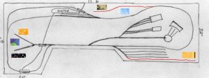

I like it, you have a lot of room for scenery and/or industries. You might add some sidings for industries, mines, etc., if that's where you are leaning.
I'm no operations expert, but: You might also connect part of the yard back to the main and add an aux/caboose spur, as shown in red. If you don't add any industrial sidings, you could do another passing siding near the turntable end, but I wouldn't do both, as it may get too tracky.
Also, if you are so inclined, you could download atlas freeware and draw it out that way, which will help ensure it fits using commercially available turnouts and sectional track. Just guessing your min radius is around 12" now.

Thanks Jon. Where would you connect the extra sidings for industries and what type? I don't think I can connect the yard back to the main because it starts a 2% incline where you marked the red. You were correct on the radius .

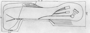

this is my layout - and preposed yard - see the thread about this here
