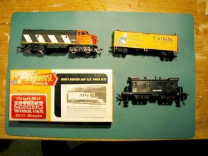

I borrowed a digital camera last night and took a few shots. Here's where my own goose is at...
Start with the Old Time 3-in-1 kit from Roundhouse for the floor, trucks and box cab diesel.
Instead of the old box car, I used an old reefer to get the right style doors. It means my goose has a metal end, not wood, and hatches in the roof, but it adds character(!). I also got an old "rear wheel drive" engine from Bachmann, since I want the goose to go!

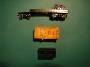

Part 1b
Cut the end off everything...
It is a diiferent reefer - I cut it up before I had the camera...

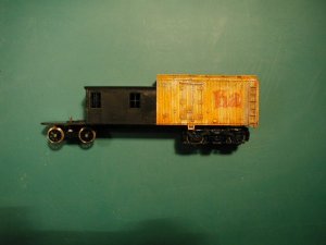

Part 1c
Here is a dry fit of the parts from the previous picture.
Next is the hood/engine for the front end, and a plow. I made the hood last night, but no picture. It is cut from just behind the cab of the engine in pic#1, so it's got screening on the sides, and rivets on the top. Picture to follow...

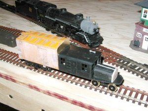

Dry fit of major parts
Here is a shot of all the major parts complete, and dry fitted. Nothing is glued yet!
I think that's superb MasonJar!
For years my wife has bugged me to make a "goose" as I refused to spend $400 on a brass one for her!
The motor/powered truck looks remarkably like the one fitted in the B/mann street car. I think you just brought me closer to building such a charmer.
I'm assuming the spoked wheels came with the MDC Old-Time kit (I didn't know that kit existed!).
Dang!! my wife just passed by and saw your Goose :eek: . She's tugging at my sleeve now saying "There you go, there's the gen on how to do it!!!). Woe is me :( :( . Looks like I have no excuse now.
