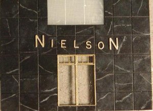

I'm intrigued enough with the thought of how it could look that I've decided to go ahead any make up a front wall and try to get that marbleized (sp?) look. I'll just hold off on the brick till then. While I could just use styrene and scribe it for the size of block, I might wait till I get to the hobby store Thursday and see about using what is sold as sidewalk. Anybody duplicated this type of wall before?

I have painted theatre sets to look like marble, but nothing this small...!
To get the look of the marble, you use several colours that are blended together while wet. Just sort of smoosh the brush into the surface with a jabbing motion.
For the black marble, you probably want two or three shades, some white for flecks, and a grey or white for veining. In 1:1 scale we used a feather to create the veins in the marble. You probably want to use the tiniest brush you can find, with half the bristles cut off...!
You will have to seal it with a gloss coat to give it a shine. We washed the entire thing with an orange wash to make it look "antique", but that was for under the stage lights.

Wow. Lots of activity here. Andrew, thanks for the description of how you painted marble 1:1. Perhaps tonight I will practice on some scrap styrene. My original thought was to try applying silver and gold to gloss black via a "mini sponging" effort. That is, to try to apply say gold to a dry course sponge, just enough to lightly coat the very top edges of the sponge, then use the sponge as a rubber pad to transfer the paint, like rubber pad printing. Or the old flick the toothbrush idea may be tried as well. A very tiny brush with half the bristles cut off may require more talent than I possess! Ken, one of these days I should get a good printer so I can try some of the things people do, like print brick paper and maybe granite and marble walls. And pirate logos too. My 8 year old $50 printer ain't going to help me here. Speaking of pirate logos, many thanks to both Ron and Blake. Blake, I like that logo, can you add the word "cement" to the bottom of the circle? Looks a lot like a logo used on the nose of FA's, doesn't it? Maybe a cement hopper owned by Ragnar Cement will need to be built. Are you able to print it so I can sand and apply it? Val, I too thought of the laminates used for counter tops. I mentioned it to Blake, who thought the material would be difficult to work with. I'm not sure where I would be able to get a small (say 7x14") piece not laminated to a counter top already. My rectangular piece with just two good sized openings might not be so difficult to cut from it. Hey, I'll try anything once, twice if I like it. Thanks for the compliment on the trestle Woodie. I spent a lot of time on that and I'm happy with the way it turned out.

Thought I'd show you how my wall is coming along. It took me a month to find a source and then get the letters. They are from Plastruct. SD90, sorry I didn't respond to your question, I meant to then forgot. Mine are just Walthers kit parts.
