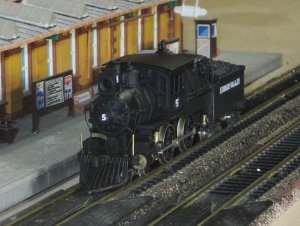

DSCF0028.JPG * This is my last completed Scratch N Bash Project. The locomotive body is scratch built and made to fit a AHM drive made by Pocher which was kitbashed to change its appearance. The Pocher tender is used and kit bashed to look appropriately.
* This camelback was never available as a ready to run model. Being modeled as a LVRR class E-27 it is one of 6 locomotives of the class. All these Victorian era locomotives were special, but for the Lehigh Valley's the E-27 class, was extra special. Four of the 6 were single digit locomotives, numbers 2,3,4,and 5. The remaining two numbers are 424 and 309. All six were built by the Lehigh valley at their South Easton Shops. With LV engines being honored with names of well known company executives, employees, and destinations, this class had some of the best names. Locomotive #2, ASA PACKER, #3 Niagara , #4 Robert H. SAYER, #5 David Laury, # 424 James Donnelly, and #309 Charles B. Cummings. The choice to name my locomotive was #5, The Honorable David Laury. A man with quite a long list of accomplishments, a LV employee, and a friend of Asa Packer.

Very nice! a well done project to build an unusual locomotive; thanks for sharing. I recognize the chassis, otherwise I'd have thought it was brass.
