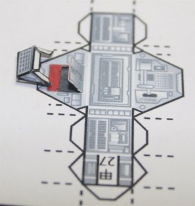

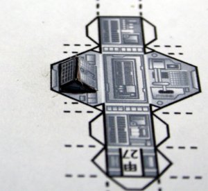

Card_noob, this is in reply to your message about parts 9 and 9a. My theory is that you don't cut out the red areas. I think you cut out part 9a and fold it like one square wall and two triangular ends of a pup tent. On parts 9, I think you just cut three sides around the gray rectangle within the red area, and flip it up to form the other wall of the tent. Then the red area is covered up by the resulting tent structure.
You know, really, this kit is a good argument for building one good nut and one good pod of each shape, and then making a mold and casting replicas in resin. Next time, maybe.

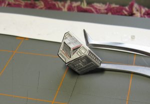

I did one by cutting out the red and the result is pretty much the same. :)
This way the the tab at the base of both sides (triangles) adheres along its full length but clearly either way will do.
