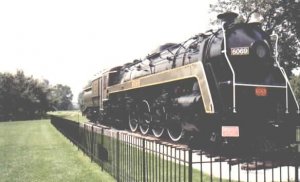

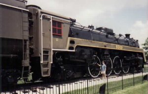

My 3 pictures of 6069.
interurban
Resting at Sarnia.
Taken by a friend and his daughter.
First shown on the out and about in Ont thread.
Hope you don`t mind me moving the old Girl here.

Hi Dick, yes, Thats Trish, She is now a tall slim teenager:)
One of my best Students When I was Teaching Martial Arts.;)
May be one day we will see a picture of Trish back with our other girlfriend 6069:D :D :D
I`ll have to talk to her Dad;)

Hello Everyone. I found this site through a search for Engine 6069 and it came up with a link to this site and the "My 3 pictures of 6069"
We are currently forming a group together to look after the old girl and give her somewhat of a makeover. If anyone has any other photo's of old 6069 and would like to share them or would like to find out more, they can contact me at(engine6069@sympatico.ca)
