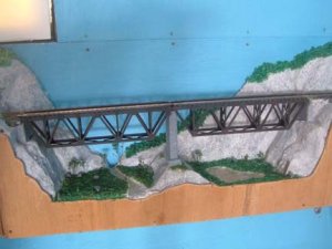

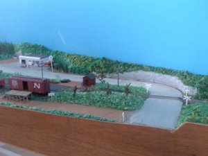

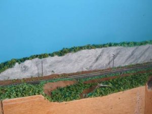

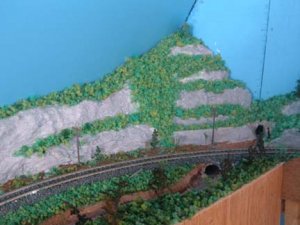

Mountain{?} construction
I don't know if these qualify as "mountains"but they'r part of a mountainus area.
I made mine with foam{white,cheap}covered with cheesecloth soaked with "polly-filla" then coloured with a wash of gray paint.
The crossing photo just kinda got chucked in for the halibut.
