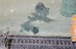

Here is some dark green foam as ground cover on a diorama hillside.
(That's a scratch built utility pole, and the tail end of my galloping goose just in the picture.)

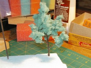

Chris -
It was not difficult, but it is a bit time consuming.
I found that cutting the foam into small chuncks first helped quite a bit. Also, when you think the foam is ground enough, let the blender go for a few more minutes. Then it will actually be ok - small, fine pieces.
The thing that takes the longest is letting it dry. After that, it only takes about 5 minutes to make the tree.
I am at a bit of a loss on how to colour the red and orange sponges - maybe I need a fall scene...! I don't know what to do with the blue ones though...;)
Andrew
