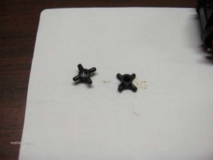

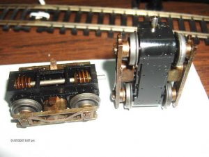

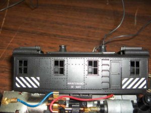

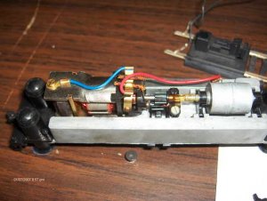

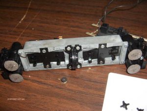

I managed to pick this up on ebay to help me along w/ my track maintenance mission :). I didn't pay that much for it and it is in overall great condition. It run but the wheels didn't move. Took it apart and it looks like age got to these 2 plastic x pieces that attach to the shaft of the worm gears inthe trucks. Has anyone ever seen this car or these x's before? Can i buy them somewhere our would i be better making my own out of delrin, nylon or abs? The shafts also have an odd measurement, .092" diameter.
I also have designs on articulating the 4 buffing posts :). Right now they have a very soft spring in them, i was thinking of putting a crown gear setup at the tops of the shaft and putting a high speed motor (like from a tyco ho scale slot car) and have them rotate :). I'd have to figrue out how to hide that setup but it would be able to buff the tracks to a mirror shine!!
One last question, does anyone know what that material is on the pads of the cleaners? It is almost like velour in cars on the crappy old gm models.

The car itself is an MDC/Roundhouse boxcab deisel. It uses the same chassis as their climax kit.
Unless you want to beg, borrow or steal (or ebay), those specific universal joints are going to be very hard to come by. MDC/Roundhouse was bought out, and the new company is not offering parts for sale separately.
I happen to have ONE complete universal (one of the ends in your pictures, and the end that goes into the huge gearbox). My climax kit only ad the one, and I've since cannabalized the kit for other projects. You can have this one if you are interested, but I'd recommend that you find a way to make your own.

Somone is selling a lots of stuff on ebay w/ the pads as part of the lot. I can't find them listed anywhere in google so they must be out of production.
The x ends aren't that hard to make i can make a crude one w/ nylon and a hobby knife and drill out the shaft hole. I'm noticing that allot of people on google want to remotor this model.

The parts have arrived and i've successfully repaired the train!! :) THANK YOU!!!!!bounce7
