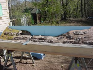

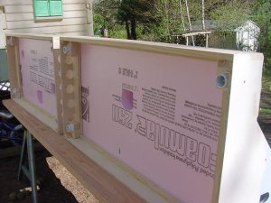

Having trouble getting the Peco switches to actuate with Tortoise switch machines. Since my modules are made of layers of 2" thick styrofoam I have to pocket the underside to mount the switches.

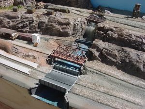

On the Tortoise switch machines I went to a heavier wire but it still flexes and actuation is not 100%. I am about 1/2 to 5/8" away from the underside of the switch. I was told that I can eliminate the slight flex by adding a tube over the wire. Will have to check my LHS.
