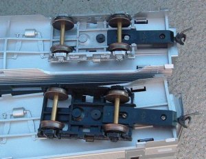

I took one of the Con-Cor trucks off as suggested, removed the wheel over the existing coupler and noticed that the geometry/layout of the Con-Cor truck is significantly diferent than the IHC one in your photo which is what the Kadee 508 is designed to work with. It appears that there isn't enough plastic "real estate" to allow the placement of the self tapping screw under the wheel. Since you did this with Con-Cor as well as IHC I'm assuming my fears are unfounded....correct?

Here's two of my Con-Cor cars, a coach and a diner. Both are screwed in---I glue on occasion but only as a last resort---scale length trains can be really hard on draft gear boxes. As with most Kadee installs, they're more to be considered as recommendations, the final installs are still pretty much up to the ingenuity of the installer.
The wheelsets are 36" and definately keepers. They've not given me a bit of trouble.
