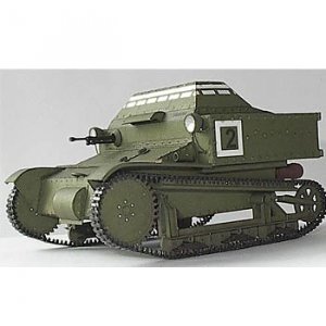

Here are two images from Modelik.
For those of you wondering about copyright issues here, the "Fair Use" doctrine allows the use of such images as part of a review, and if they are properly attributed.
These came from www.modelik.pl. Consider them part of Charlie's review.
