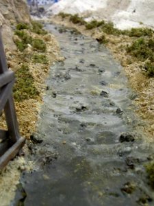

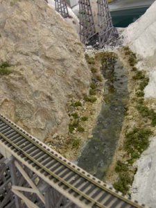

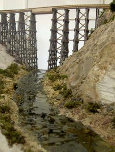

Hello, I am approaching completion of my river. It is just a generic canyon/gorge type river.
All criticisms (even negative ones) most welcome. It is hard to judge if you are heading in the right direction when you are working on a project by yourself with no external input.
I still need to add some water effects to the surface and tidy up the banks a little, but thought I would post some pics and ask for any feedback.
Thanks for looking. (made with Woodlands scenics ez water)

Wow, hard to say anything negative about these shots.:) Great modeling.:thumb: I can't wait to see the finished product.
TrainClown
Looks real good! The only thing I might suggest is an A/I wash on the cliffs to bring out the details. A/I wash is made from 1/2 cup rubbing alcohol and 2 or 3 drops of black India ink. Washed over the rocks with a broad soft brush will allow the A/I to pool in low spots and cling to crevices. When it drys, it has quite a nice effect. The idea is to mix a weak solution and apply it in repeat washes to darken it to where you like. Let it dry between coats. This will also make your tressel look like it has seen a few years of service.

that's far better than I have ever been able to do with EZ water. Nice Job.

You probably need to dry brush some white on the river to get the feeling of rushing water, especially if the water is running around any rocks.

thanks guys for the comments. Yes, a wash of india ink over the cliff and dry brushing white on the surface for turbulence effect are the next steps. Thanks for that advice.
Also need to establish more definitive river banks in areas.

This is particularly obvious in your third photo... You caught it before I could say anything, :thumb: :thumb: The "realistic water" product from Woodland Scenics gives you a little more control than the EZ water. Both products are relatively thick, and their surface tensions cause a lot of "climb" ( makes the "water" appear to curve upward). with the Realistic water, you can use a fine bristle brush, and water to thin the product along the edges, so the "water" sits "in" its course.
Your first two shots are excellent! Well done! :thumb: :thumb:

Maybe some bushes and "hanging on" trees on the gorge walls.
Other then the points you already said are your next steps...
SWEET!
