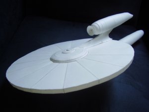

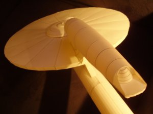

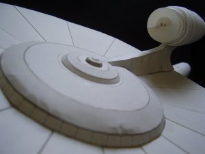

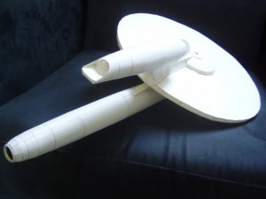

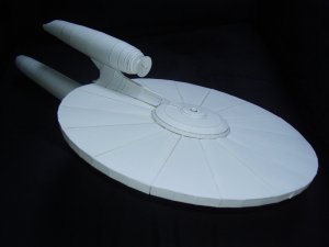

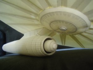

This is the prototype build. Now I can start redesigning it. Overall length is 59 cm from the front end of the main circular disc to the back end of the engine, and I used regular old 80g paper for the build.

WOW!
That's really impressive!
I love the gentle curves on the nacelles!
Your choice of doing sections for the disc is interesting. Normally, I would have done that as concentric rings. But they turned out really really well.
Congratulations!
It's texturing time. :)
EDIT: Oh silly me.... I forgot about the scale you were working with. Had you done the disc using concentric rings, it would not have fit within an A4 sheet. :eek:ops:
That's one heck of a prototype, my kid sees that and he'll bug me till he has it! One to watch!
I'm not sure what is considered the primary hull, but if you mean the saucer section, I would have to agree. I am starting to wonder if a combination radial and petal design should be investigated. This offers an exciting alternative.
