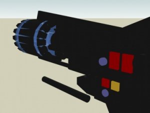

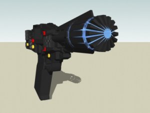

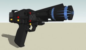

So, this is a little update on the muzzle. It will consist of transparent sheet with the detail parts glued on. The SketchUp renderings show how it is supposed to look in the end. If everything works you'll see the black backs of the glued on parts through the transparent areas which will make the whole muzzle appear completely black. When the trigger is pulled, the muzzle is lit from the inside and the light is shining through the transparent parts. This is the exact way the original prop was designed; the only difference is that they used a completely transparent muzzle and painted the detail parts black from the outside.
Build pics are coming soon. Have a nice weekend! :wave:

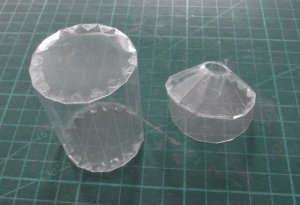

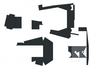

Here comes the muzzle. After two unsuccessful attempts I finally managed to assemble the plastic sheet parts. I was about to quit the sheet and build the muzzle of acrylic plastic (from CD jewel cases) because the parts wouldn't stick together. Then our fellow warrior Rhaven Blaack opened my eyes: I simply used the wrong glue. Thank you very much, RB! :curse:
You literally saved my day (and an essential part of the project)! :thumb:
BTW, the edges are intentional for three reasons: They serve as alignment marks for the greeblies, the greeblies can be glued onto a flat surface (no bending around round corners) and if you build the light & sound version the light from the LED is reflected by the edges which makes the whole muzzle flash. :rolleyes:

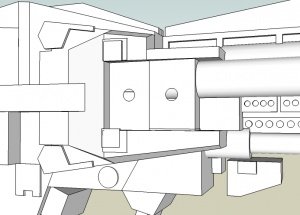

Well then, according to the principle "if I can build it, you can build it, too", I only have to test-build one last greeblie before I switch to the textured prototype. The pictures show the part in CG and unfolded (still unedited and without flaps). Yee-hah! :twisted::twisted::twisted:

Wow. That is looking very nice. How in heck do you score the plastic sheet, without cutting through it!!
*Talk about steady hands!*

I score it VEEERY gently with the sharp edge of my cutter. Then it can be bent like normal paper.
