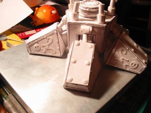

Here's what the toes are looking like:

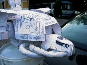

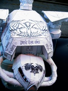

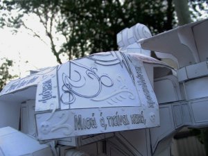

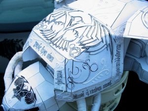

Here's some pics of the raised surface detailing on the carapace armor...all hand cut and glued. The script is Greek (not Latin) and it is all hand cut and glued down.
