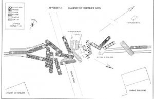

Around milepost 17.98, the end of the journal of the rear axle of the 33rd car of the train falls to the roadbed. It is red hot. The rest of the axle and the two wheels are found, glowing red, in a backyard.
Another mile and the tank car is tilted about 15 degrees. Sparks are shooting from where the truck is scraping along the ballast. The front wheels of the rear truck have derailed at mp 16.82.
At Mavis road, mp 16.56, the truck meets a trailing switch and is torn from the car. The tanker stops; the following cars turns sideways, and 24 cars are spilled over the level crossing in a space of just over 400 feet. It is a few minutes short of midnight.
Nine of the cars contain propane; one contains chlorine; there are 3 cars of styrene, 3 of toluene, 4 of caustic soda and some boxcars. All the cars originated on train 4 in Sarnia.

In the middle of the next city west of Toronto, there are twenty-four cars piled in a heap. Nineteen contain “Dangerous Commodities”. Within half-an-hour three of the propane tankers have exploded; parts of these cars have gone 145 feet east, 440 feet southeast and 2,222 feet northeast. The front of the train has stopped just over a mile away.

What I left out of the story was the suspicion of the cause. The truck in question had oil axle boxes, i.e. not roller bearing. The cars were checked in Chatham before being added to the CPR train. It was said that the axle box had a lubricating pad in it (to move the oil from the bottom of the box up to the journal) that was a size too big.
There was debate about whether that would matter or not, and whether it had happened. Apparently, at one yard the pads were all separated by sizes except for the two largest which shared a box. The pad itself was burned.
A lot of the recommendations of the inquiry were moot, because the railways were already implementing them. There was some concern that even if tank cars were given roller bearings, the car in front might be something else with plain bearings.
