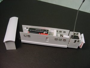

Bill Pontin
About a week ago I responded to a post about making a car to hold a mini camera. When scratch building, I like most of us, could not leave well enough alone. This front end, to house the camera, looked too much like a rotary snow plow.

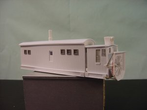

Bill Pontin
Still working on it, but here it so far. Still have to make a roof for the plow crew.

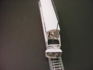

Bill Pontin
Managed to squeeze everything into my version of an "N" scale rotary snow plow.

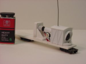

Bill Pontin
The car is jointed or articulated so that I can swivel the camera. Not prototypical but it works great.

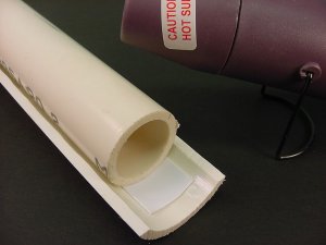

Bill Pontin
Ruined a number of styrene pieces trying to get a curved roof. Found an easy solution by sectioning a piece of 1 1/2 inch PCV pipe. I heated the .04" styrene with the wife's embossing heat gun. (shhhh, not suppose to touch her stamping stuff) When the plastic softened I then formed the curve with a section of 1" pvc.
hswn
Now you just need a snow storm. Looks great.
Thanks for the idea of using the two pieces of pipe as a mold this will no dobt come in handy, I'm thinking caboose roof. However I'll have to use the B&D heat gun, I'm not married, I have to provide my own tools.

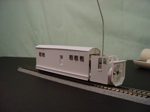

Bill Pontin
Tyson the last thing I will do is bend the antenna back about 45 degrees. It will still hit tunnel portals but should bend or flex to clear. The one I saw being demonstrated at a show was going through tunnels and under an overhead signal the antenna was just pushed down further. In either case, my module is the only one in the club that has several tunnels and those can be avoided by staying off my blue line.
Added a little more detail while watching TV tonight.

You could always make the antenna look like the power pickup to an overhead wire. Don't know if any snowplows were electric powered, but it's a thought.
shaygetz
I curl mine back 'til it's just above the roofline by an inch. It still catches low scenery, with a special appetite for signal towers but it works well and doesn't affect the reception.

MCL_RDG
Wow!
#1- WOW!
That's freakin' kewl!
#2- Thanks for helping me with how to create new roofs for my passenger cars.
Mark- an avid NYC fan!!!
Bill Pontin
Mark, when forming the curved roofs, heat the styrene in the sectioned PVC. When it starts to sag slightly press it down to form the curve with the smaller piece of PVC. Took a little practice to evenly heat the styrene, it seems to reach the softening state slowly and if you go too far with the heat it will deform. Good Luck. :)
