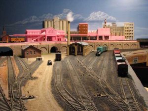

Here is a pic of the completed yard. Tell me I don't have to rip it up.

What I do is use a magnet but you know that already.
NEXT I would suggest that you use a powerful vaccuum and suck up as much lose stuff as you can, then reballast the holes with the stuff you check with a magnet.
THEN reglue that sucker good.
I have made the same mistake and that is what I did to solve the problem and it worked for me.
Either that or do a redo. :( But I don't think you need to to be honest.
Hope that answers your worry. :)
I would be concerned about this. I would rip up the track and remove the ballast. What yopu have is created a hug resistor. You can actually create a load acoss the rails. What is a load? It would be like adding another locomotive or more to the train. It can also over heat your throttle control because you are drawing more current. I'm sorry for giving you some bad news.:cry:
Andy:wave:
N
nachoman
90% of the ballast? That is unacceptable. Like throwing 90% of the money you spent on the ballast in the trash. you can try rewetting the ballast and then sucking it up once the glue softens.
