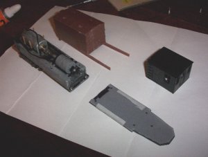

Just starting making my kitbashed MDC Galloping goose . here is a pic of the components as they stand at the moment.The drive mechanism is an old MDC climax chasis with the rear wheels only.I have remotored it with a new can motor.

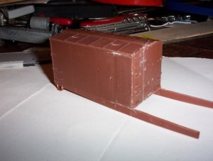

The main body was made from a Box car , i cut roughly in half . added an end to the cut section , i will have to trim this to fit over the powered chasis....

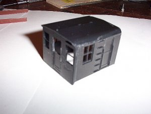

The passenger/cab is made from a Box cab diesel body that came in the kit.I have elected to make this around ½ the lenght as indiciated in the instructions as i wanted a more compact design for the railcar.This side shown was removed from another section of the cab and then glued here to match the other sides profile.
