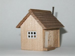

This is a follow-up to Matthyro's suggestion of fibreglass tape for windows in N scale.
For HO, I found a plastic mesh usually used for cross-stitch, at the dollar store. Two 9x12 inch sheets for $1. The grid is about 1 scale foot by 1 scale foot. Can be cut easily into any size you want. The plastic is slightly thicker than standard cereal boxboard, so you can make windows by cutting an opening, using clear plastic to cover the back, and then inserting the entire window frame into the opening.
Can be cut to any size and any configuration. I will post a picture when I get the chance.

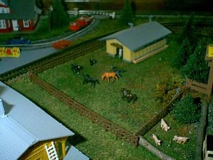

I tried to add this photo to my previous post but could not figure how to do it in the edit mode, anyway I used the plastic mesh for the fence around my horse corral to make it look like split rail, and the ladder that is leaning against the farmers market which needs a little more trimming on the rungs, best thing I could come up with without using twigs for the fence.
Hey, that's cool. I like those ideas, I just knew there had to be a good use for that stuff, especially for N. I was about to buy a fence for my farmhouse, but not now.:D :D :D :D

A picture (at last!)
Here at long last is a picture. I know someone else has beaten me to it (can't locate the thread right now), but here is my take...
