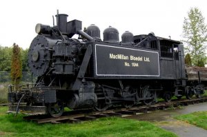

That sure is a cute loco, too bad about the pick-up problem. From the photo it appears that the two center drivers are blind and might not even contact the rail? Still, I notice a wiper on the center driver (!?!) So, in all likelihood, it probably has contact on four wheels most of the time and only on three the rest of the time.
So, a thought occurred to me: what if you could add a pilot and trailing axle to help pickup current? I live on Vancouver Island and frequently pass by this little cutey:
