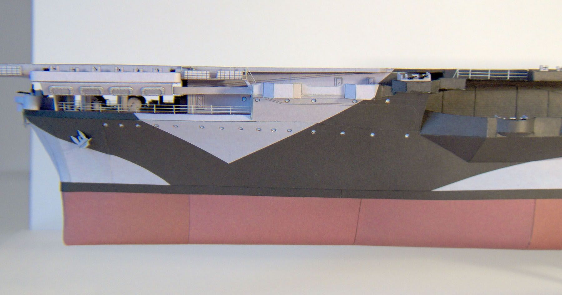

I retourned to cardmodeling two years ago, after twelve years of break and the Essex is my best work for a while.
Those photos shows the model under construction:
Blue flight deck and planes were not with the kit, they were designed by my friend Origami especialy for this model and are avalaible to upload on his web site with many other planes in 1:200 and 1:300 scale.
http://www.republika.pl/waspcv7/warsztat.htm
I made some Dauntless, Hellcats, Helldivers and Avengers. Total 30 pieces.
Spinning propeler effect is printed on transparent plastic card.
The planes with the kit were violet and poor.
The masts and radars i made myself with thiny iron and copper wires and cyanoacrylic glue.
Finally, some photos of finished model.
I hope it's not to much and You enjoy to watching the pictures. :)

The kit is newer version. The old one is hand-drawing, the new one is computer-redraw but with many mistakes in colour scheme.

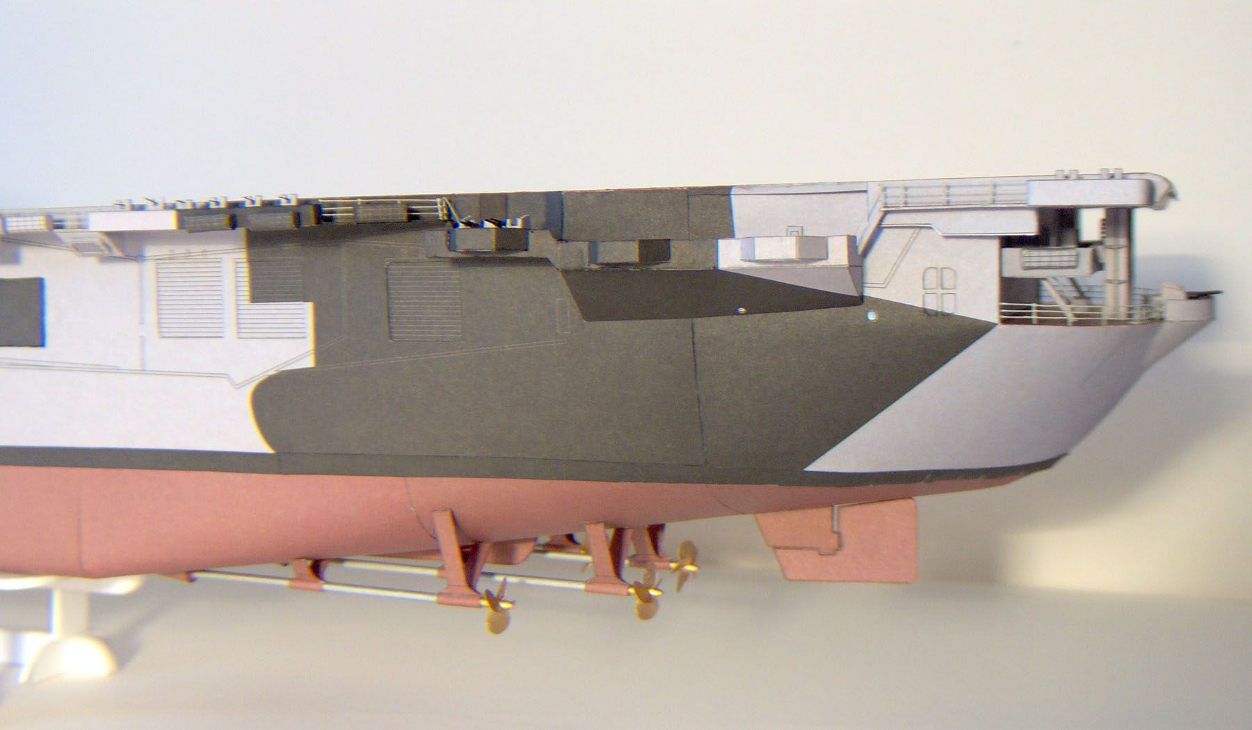

Fit problems. Dimmensions between frames are too big and paper is too thin, so it's hard to build the hull correctly. I had fit problems at the stern, starboard was too short 2mm and portside 1mm.
Other parts were, I can tell, good enough.
Darwin, like cmdrted said, metal parts hold together good. Using cya is easier, but solder is more solid.
I know nothing about any deck equipment that You asked, sorry.
Milenio3, the Essex won bronze medal in Porabka cardmodelers competition in 'warships open class' with 89 points, she is not good enough to win internationals competitions.The Essex isn't fulfilling theirs regulations, I made too many changes if compare with original kit.
Maybe next one will be better, it's GPM Zuikaku 1:200,actually under construction, really big one :)

Thank You Darwin. About the Essex hull You're right, there's not enough formers and filling the hull with styrofoam blocks seems to be good idea. It should prevent plating elements from collapsing.
I've used similar method for Zuikaku hull.
The flat parts of the hull are covered with 2mm cardboard.
The formers were copyed two times.The copys were glued 2mm from the edge of each side of each former. :grin: Next step is gluing 1mm cardboard straps (1cm width) on added supports between formers. After that the framing was painted with varnish to reinforce it. The framing, prepared so, was next ......(?) and sanded. I hope it's intelligible enough. :eek:ops:
And covered with boards and plating elements.
It's only one of many alternatives and filling the hull with styrofoam blocks is the good idea also, but need some practice in to work.
