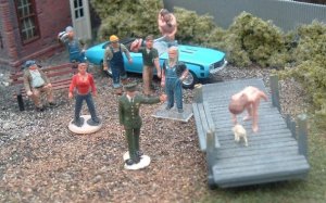

I buy Prieser, Model Power, old Plasticville and Bachmann unpainted figures, then modify about 1/3 of them to avoid repeated poses. I move or change limbs from one figure to another and heads get turned from one side to another. Hats are cut off of limbless carcasses :eek: and modified to be held by others. Torsos are cut to bend them in a variety of ways. Some figures are cobbled from several different figures---the girl is made from 3 and the embracing couple 7. I make a putty from the sprues of each figure set dissolved in liquid styrene cement, place it where I want it, let it harden then carve to desired shape---see Red Betty's chest (started life as a Plasticville brakeman), Bubba's beard and the girl's hair and figure. Modifying figures allows me to bring some artistic still lifes into my work that just can't be purchased.
