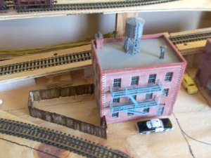

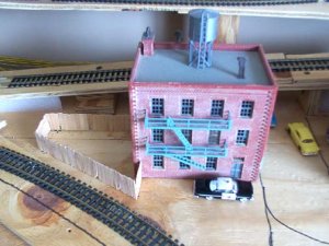

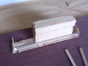

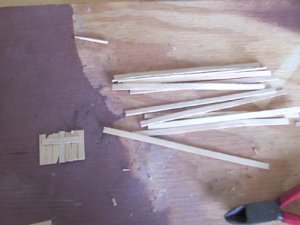

First lets use wooden coffee stirrers cut to fence scale height and make a couple of fences out of them. :D I used elmers white glue and used a long stirrer behind all the smaller planks. Then I used round toothpicks as uprights to hold up the fence. I drill a small hole in my benchwork and insert the toothpicks. Since they are tappered they all go in to the same depth. Then I glue the fence to the toothpicks and clamp with clothes pins until dry. I can then remove the entire assembly and add additional glue for a sturdier bond.

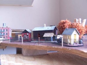

Second I used screen porch plastic screen to make a different kind of fence. As you can tell by the pictures I again used toothpicks for my posts and staggered them. Not a bad result for using items I had around the house.

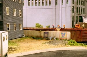

Stripwood and scale lumber fences....
Fences are a great way to "personalize" a layout...I decided to build a few and put ads and posters on them from friend's companies, my childhood, etc...here are the results, next to a Earl Smallshaw's tenaments on my E. Mo. Ry. Anyone from NJ recognize that poster on the left?

Scott,
The fence in the third picture is made from left over porch screen which is nylon or plastic (you know what I mean) When I had my porch screened in I grabbed all the left overs for my layout...and my neighbors left overs also.
It is great for mountain bases and fences and I also cut them out for securing stands of trees. I put down waxed paper then the contoure cut screen and glue the trees in place. Then I just peel off the waxed paper. This way I can lift out the whole lot and work on detailing and just put it back in place. Or I can change that area completely if I get tired of it.
