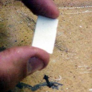

I've been working on some wtructures for the layout, & needed something to represent wooden doors...
I use this same technique to make loading platforms, porches, & walls...anything that needs to look like planking.
This piece will be cut into 2 N scale doors, so my apologies for it being a bit small...I must also apologize for a couple of the photos being a bit blurred
The 1st photo shows the piece of plain white styrene I started with...
(btw...this is the 1st of 6 photos)

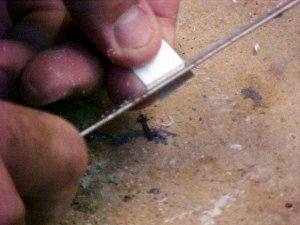

First I take a razor saw, & saw parrallel grooves in the piece, roughly 6-12 scale inches apart...

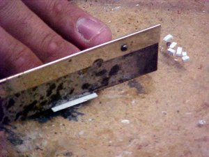

Next, I drag the teeth of the saw blade sideways to form a "grain" in the "planks"

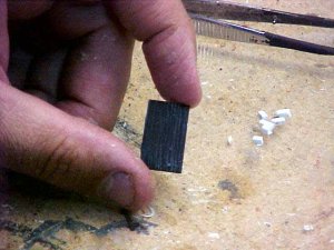

Now I paint with flat black spray paint...

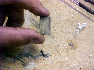

After the spray paint drues, I dry-brush with Polly Scale Dirt, Mud, Earth, & Aged White, then I give it a wash of India Ink & alcohol...
And the result (hopefully) looks like some weathered planking...
