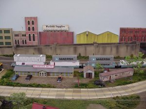

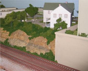

Bob,
Retaining walls aren't difficult to make. Here are pictures of two retaining walls on our club layout. The first was made from sheets of cast Hydrocal, cut to fit the grade and the second is Masonite (smooth side out), painted a concrete color.

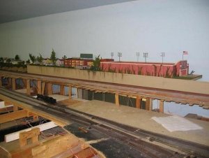

Bob,
Here's a closer picture of the Masonite wall. It's an earlier picture and the building at the right edge of the picture has since been moved. I used a piece of Evergreen styrene angle stock to finish off the top of the wall (I don't remember the size). It's a quick and easy way to make a wall.
