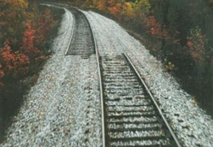

Iron Goat
I'm glad I don't have track problems...... hey, one outta two ain't bad !
Bob :eek:ops:
