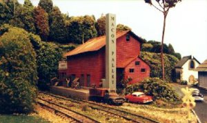

My cheap scanner won't do a good job on the sign but oh well. I made the sign by masking off a portion of the brick and spraying it white. Then made a water slide decal on my puter and overlaid it, then soaked the decal with decal softner to have it mold to the brick. Sprayed that with a few coats of dulcote. Inspite of the scan it looks great in real life, just like it was painted on the building.

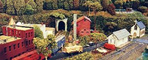

I threw away the roof and roof details (put em' in the junk box actually) and used metal roofing more typical of here. Rusted the roof with Rustall. The chimmney was made from pieces of Plastastruc, and the "concrete" loading dock/foundation from balsa wood. The extension facing the camera was shortened by about 3/4. The rest is just paint and weathering.

Very nice work, Tyson!
All the changes you made make what was once a fairly generic $2.00 kit, much more of a craftsman project, & something that is unique to your RR, & therefore very realistic...
That's exactly what I like about those cheapo kits...with some knives, files, saws, paint, glue, & some imagination,you can transform a box full of pieces into something of your very own.

Now this is a great example of kit bashin. Tyson, the way it blends into the scene shows you have artistic talents. I love all those trees to which add a feeling of realism.
Nicely done.
Your camera works fine but a nice digital would make it easier for both of us.
