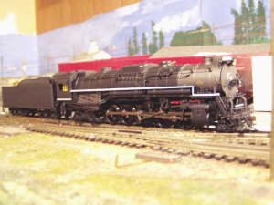

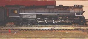

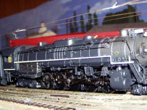

interurban
Aug 21, 2002
4,407
76
Pickering. Ontario. Canada.
Thanks Andrew.
I am a bit behind with this DCC stuff, since I bought this steam engine with all the features, I may be looking at this some time soon.
I LOVE this 2-10-4

Chris... What's this... diesels, now steamers? What happened to the overhead?! :eek: ... Nice loco! Is that a BLI?
Andrew
Yep $500.00 worth, ouch.
As you will remember Andrew the old L/O is a coming down as I type :cry: :(
The new railway room, will allow a compleat circuit for a nice steam/diesel run.
There will be Traction and a town for the traction action.
:thumb:
